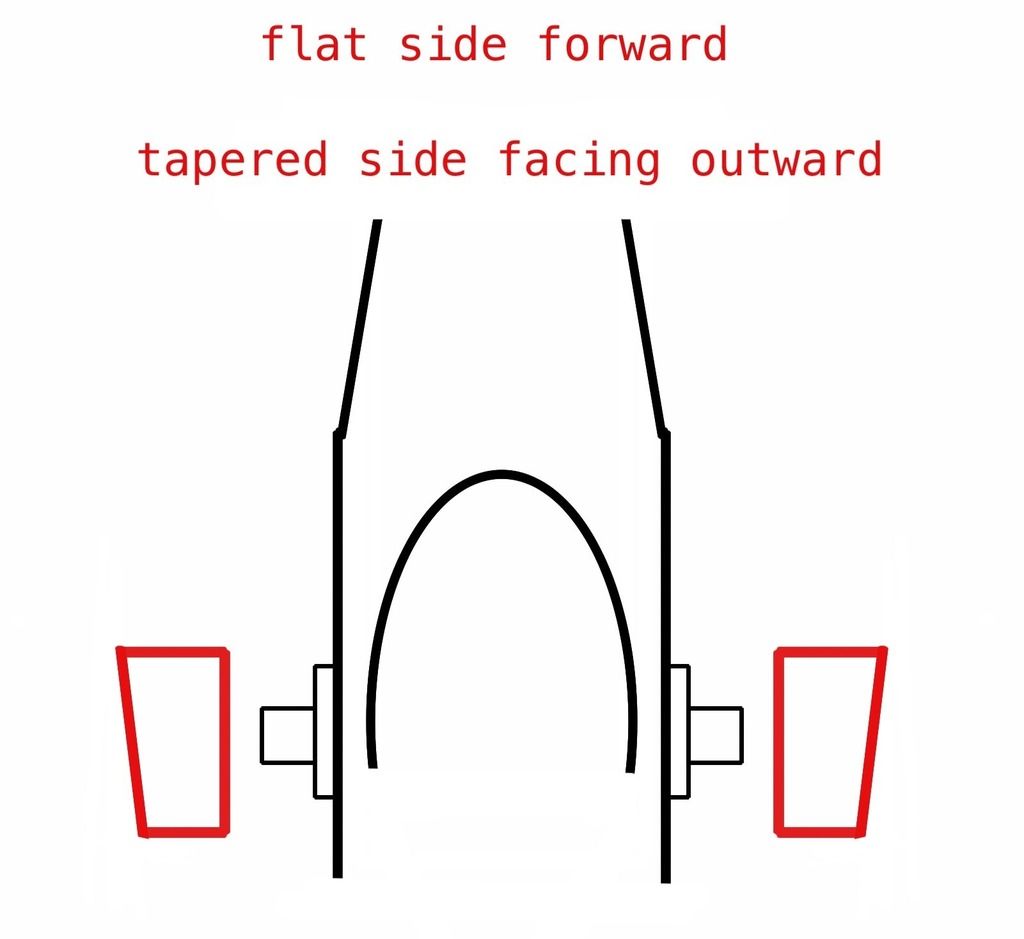

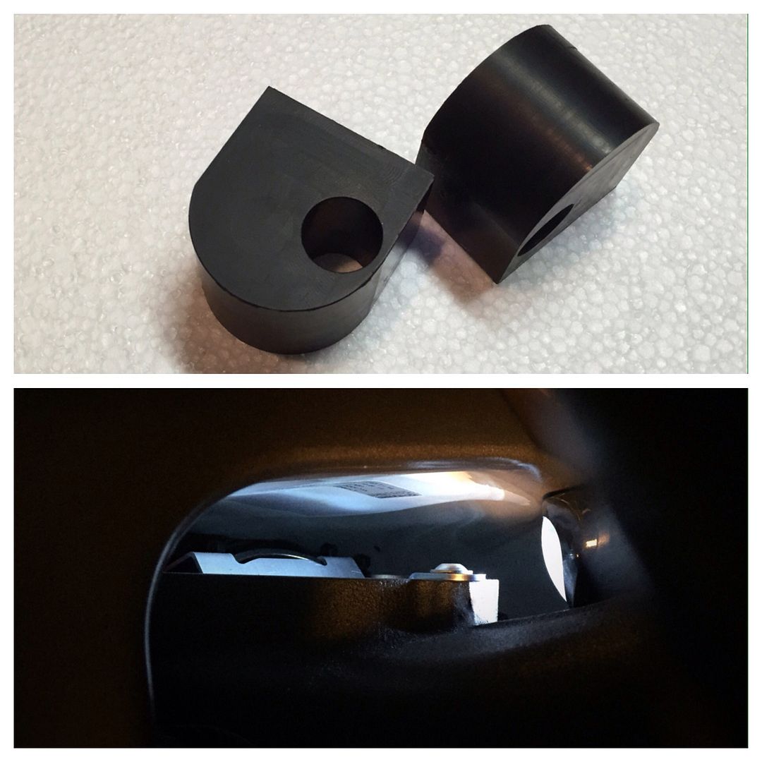

Needed just a tad more space under the tank for a project I'm working on. Designed some tank lift adapters to accomplish this. Others have since asked if they could get a set so extras have been made available on eBay.
The adapters are flat on one side and have a slight taper on the other. When installed correctly, the tapered sides should be facing outward.

Got the cover made for when molding the negative space under the tank.
