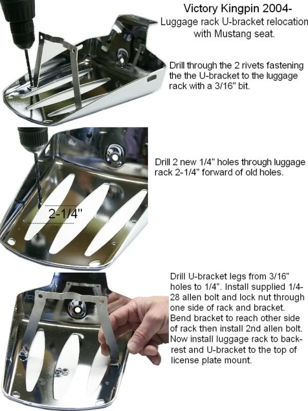

Discussion Starter · #18 ·
OneThumb said:
Texastoad said:
How about the stock luggage rack....does the Mustang seat work with it?
So thecircle starts all over again, back to puddleducks first question.
No, not without modding the rack.
Here is a post from the VMC:
